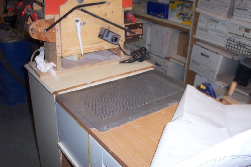

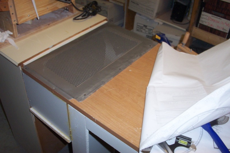

There you go folks, at the request of my great Pals Ron, Hesh and Billy, here are the pics of what i built, it's made of melamine slides for the dust chute, the grid or screen? is a recycled thing i scrounged somewhere around here, the holes are ~ 1/8" or less in size so they might be too small for an efficient vacuuming effect, i'd really love to hear thoughts and experience on that!TIA

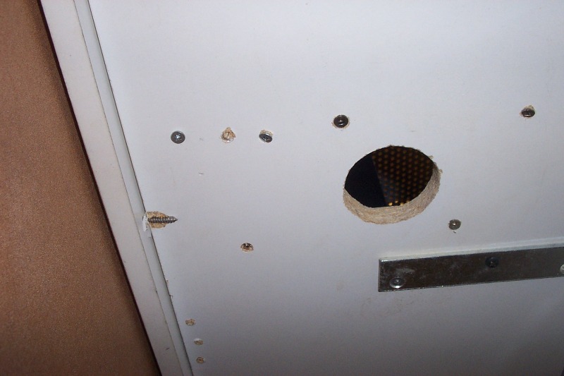

a view from underneath, i think i screwed up there!

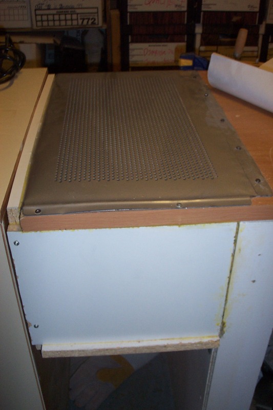

In this pic, you can see that i added some plastic blue sheets to help the dust find it's way to the vacuum hose, it also has 2 melamine planks or boards disposed in a "V" in there as well, under the plastic sheets, if i make any sense! here it is:

It's my understanding brother Hesh that a downdraft table should be hooked up to a powerfull enough DC with sufficient CFM (most I would think will require 500-700 cfm, for a small home use one that is) and that they should suck down all of the dust.
This is just my understanding from what I've read. I don't have one, but it would be nice one day.
Of course, take a read over at Bill Penz's site on downdraft tables, it has a very good chart for CFM requirements per table size.

Thanks guys for the info. I should deffinatly build one of these! Serge,I think our shop vacs aren't enough.I have been looking at some of Grizzlys DC's.

I have no experience with a downdraft table but when I toured Santa Cruz Guitar Co. I was surprised by how big the holes were in their downdraft table (don't remember exaactly about 3/4" to 1") so I asked about it. They told me that they use to have a top w/ smaller holes but it didn't have enough suction so they went to the bigger holes and that increased the suction.
